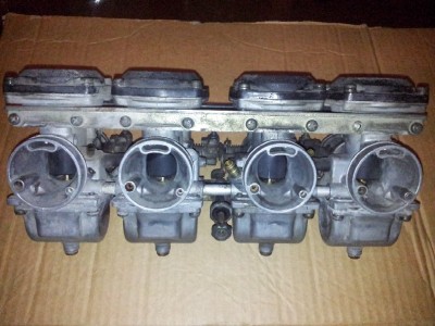

I have a set of the old BS32 CV carbs, the guy didnt get the $$ he wanted for them on TM apparently so removed all the main jets and had a go at munting all the pilots but only got one out...now I cant get in touch with him, but I haven't paid and he isn't asking for payment - So if figured it might be easier just to get some other jets.
I have no idea what size was in there to start with, but im fitting the carbs to a to a suzi engine. Thought i'd start around 145 mains and go from there. but anything you have might be helpful for a starting point??

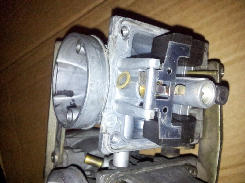

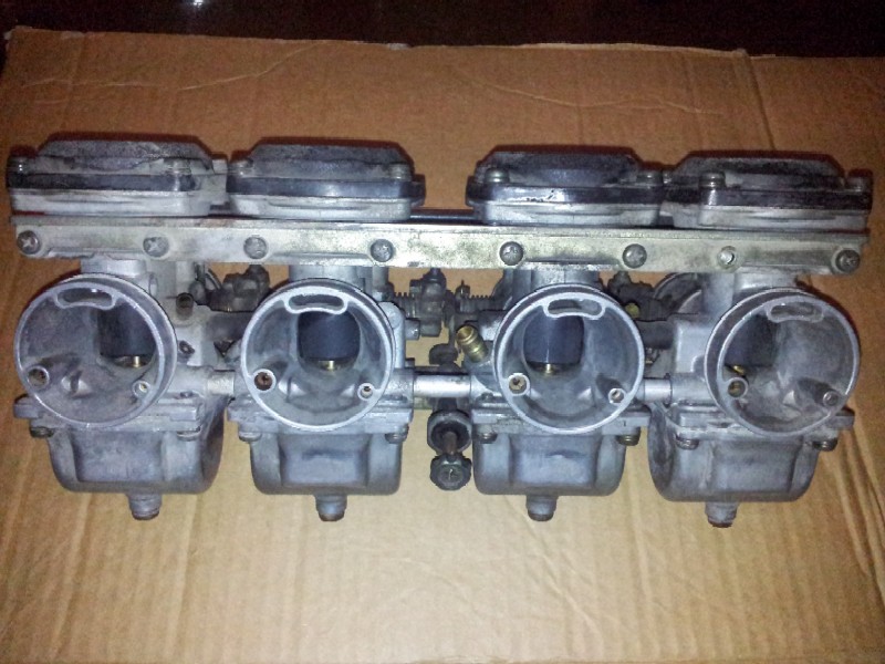

Added some pics if it helps??

Do they still have the needle jets? It doesn't really look like it....
I have some jets from a fzr thou (I thought I had more...musta used 'em somewhere...) that have 2X110 and 2X107.5. Bit small but if ya want 'em....

Hi Death, yup we do occasionally head to auckland, the inlaws are in Manukau. Yeah I would be keen on those jets if you want to sell them? I've heard your not supposed to drill them out due to internal profiles etc? but maybe that would be the way to get me close and then I could buy a few jets when I know what I need. If you would rather I didn't butcher them then thats all good.
Needle jets are still there - Got the carbs stripped right back to nothing at the moment and I'm pretty impressed for the age of them. No wear at all in the needle jets, the grooves in the top of the needles are like new, float valves are spotless..it's almost like someones put a few new parts in them recently. I did find #1 & #3 internal fuel filters completly blocked, which I guess would have made the bike run like crap..maybe the reason for the new parts..Just need some now orings and they will be going back together.
